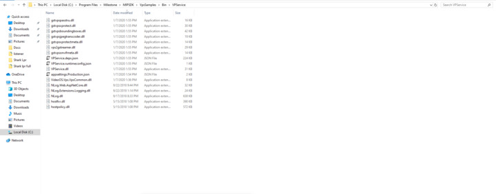

2) The output of typing Dir in directory of the service:
[C:\Program](file:C:/Program) Files\Milestone\MIPSDK\VpsSamples\Bin\VPService>DIR
Volume in drive C has no label.
Volume Serial Number is EE74-BE7D
Directory of [C:\Program](file:C:/Program) Files\Milestone\MIPSDK\VpsSamples\Bin\VPService
05/27/2020 10:37 AM .
05/27/2020 10:37 AM ..
01/07/2020 02:54 PM 1,106 appsettings.Production.json
01/07/2020 02:55 PM 43,008 gstvpsboundingboxes.dll
01/07/2020 02:55 PM 19,456 gstvpsjpegtranscoder.dll
01/07/2020 02:55 PM 13,824 gstvpsonvifmeta.dll
01/07/2020 02:55 PM 16,384 gstvpspasstru.dll
01/07/2020 02:55 PM 30,208 gstvpsxprotect.dll
01/07/2020 02:55 PM 13,824 gstvpsxprotectmeta.dll
05/15/2018 01:08 PM 399,328 hostfxr.dll
05/15/2018 01:08 PM 585,696 hostpolicy.dll
09/17/2018 08:33 PM 653,312 NLog.dll
09/22/2018 01:14 PM 24,064 NLog.Extensions.Logging.dll
09/22/2018 09:44 PM 32,256 NLog.Web.AspNetCore.dll
01/07/2020 02:36 PM 8,192 VideoOS.Vps.VpsCommon.dll
01/07/2020 02:55 PM 29,696 vps2gstreamer.dll
01/07/2020 02:55 PM 229,038 VPService.deps.json
01/07/2020 02:55 PM 31,744 VPService.dll
01/07/2020 02:55 PM 263 VPService.runtimeconfig.json
   17 File(s)   2,131,399 bytes
    2 Dir(s) 22,937,927,680 bytes free

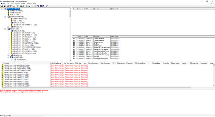

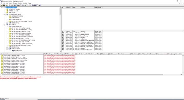

5) a) attached a snapshot and DWI file of vps2gstreamer.dll
Gaby

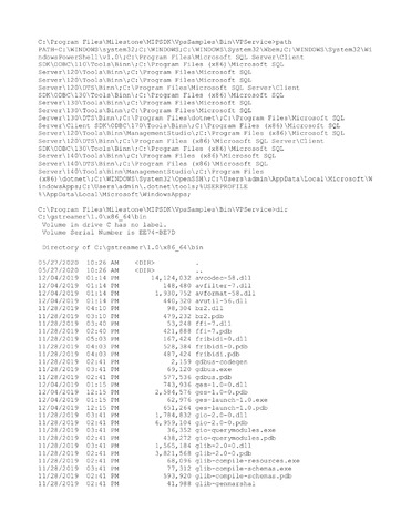

Hi Christen,
i attached the result of DIR in thebin directory
[C:\Users\admin](file:C:/Users/admin)>cd [C:\gstreamer\1.0\x86_64\bin](file:C:/gstreamer/1.0/x86_64/bin)
I gave permission to read/write for everyone in this path.
The only remaining reason is that files are being deleted.I will investigate if i can find any reason for this to happen.

Hi Gaby
We just had a similar case internally, where someone was missing the gstreamer dlls exactly like you are still missing it. The problem was that it had been installed to another path than the person thought. Bent discovered that if you ever install GStreamer for Windows using “Custom” mode, you can choose your own custom directory for GStreamer, and the GStreamer installer will remember that directory until you change it again, also in the two other modes. In the two other modes, you can’t change nor see the install path. Maybe that is what is happening for you as well. Just a hint or guess.
The directory listing you show me does not include gstreamer-1.0-0.dll as I would expect it to, and which it does when I install GStreamer here. There simply must be a way for you to install GStreamer so you get that DLL into the directory that you believe you are using it from. I can do that here. I have a very hard time explaining to you exactly why the same does not happen for you. GStreamer as such is not delivered by Milestone, but of course we want to help our partners out all we are able to. But from here, I guess you can use Google or your imagination as well as I can to figure out what it is that goes wrong.
I am kind of running out of ideas, Christen
