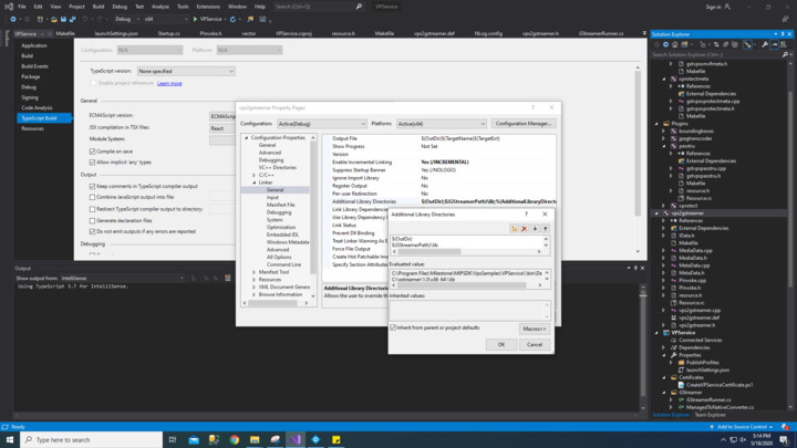

i don’t know if this is what i am supposed to look for.
i attached a photo of the vps2gstreamer linker additional library directory.
When i build the vps service project the output files are being generated in two directories.
Directory 1:
[C:\Program](file:C:/Program) Files\Milestone\MIPSDK\VpsSamples\VPService\VPService\bin\x64\Debug\publish
Directory 2:
[C:\Program](file:C:/Program) Files\Milestone\MIPSDK\VpsSamples\VPService\bin\Debug\win-x64
The vps2gstreamer.dll is located at:
what can i do from this point?
best regards,
Gaby

i attached a screenshot of the environment variables.
Do i need to add anything here?
What can i do from here?

Hi Gaby
Thanks for your patience. Now I am sure we are on the same page, so lets continue step by step from there. Since you are starting “dotnet vpservice.dll” from a directory where vps2gstreamer.dll is present, it is excluded that this exact same dll is missing. It must then be a dll of which vps2gstreamer is dependent.
The primary dependencies for vps2gstreamer.dll are GStreamer-1.0-0.dll, GObject-2.0-0.dll and Glib-2.0-0.dll. On my computer, these exist in [D:\gstreamer\1.0\x86_64\bin](file:D:/gstreamer/1.0/x86_64/bin) and I have set up my environment variable named “Path” to include [D:\gstreamer\1.0\x86_64\bin.](file:D:/gstreamer/1.0/x86_64/bin.) That will, I believe, at least on my computer make the vps2gstreamer load those three dlls. So next step is to verify that your Path includes the directory where such three dlls exist. But I guess you have been through that already, so it should not require much work to make 101% sure.
In our morning meeting today, Bent, our tester, added a possibility where the Path is right and the files are in place, but your symptoms will occur anyway. GStreamer releases its code compiled for Windows with different compilers. We use the MSVC one, because we always use Visual Studio. That GStreamer installation is made available as gstreamer-1.0-devel-msvc-x86_64-1.16.2.msi. If you installed GStreamer compiled with another compiler, it would not work, symptoms wouldbe like you describe.
It may be me who is blind or does not know how to operate this forum, but I cant find any screenshot in your latest post. If you still have problems after this mail, please paste in a screenshot of vps2gstreamer.dll (from the Bin/VPService dir) dropped onto depends.exe, the console output from typing “path” and from typing “dir xxx\bin”, where xxx is where you have installed GStreamer.
I have studied the .DWI file you posted earlier, but on my computer it reports that the DLLs located at some directory on C: (which is not where I have them, but probably where you have them) are missing. Obviously shipping .DWI files is not helpful. I didn’t even know they existed. Lets go for a screenshot this time.
If your machine is set up in a special manner, you may want to study Microsoft’s advice on where DLLs are loaded from: https://docs.microsoft.com/en-us/windows/win32/dlls/dynamic-link-library-search-order. But my guess for now is that that the problem is simpler than that.
