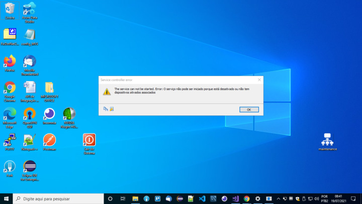

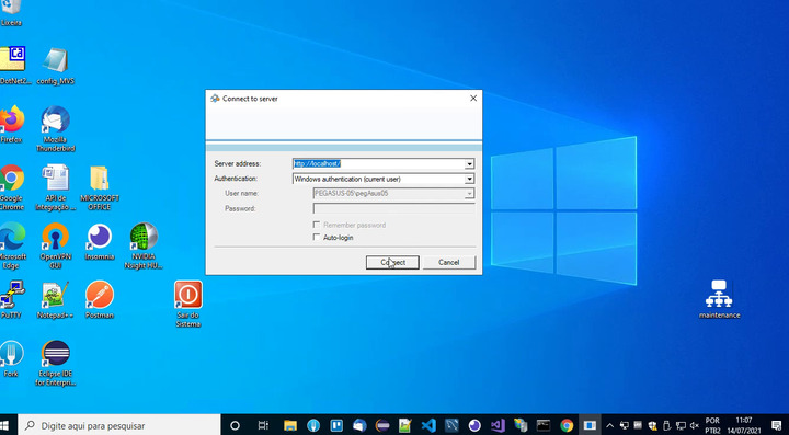

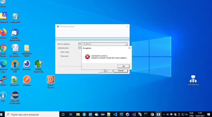

You appear to be logging into localhost (the local computer) but in your screenshot, the Management Server installed locally appears to be stopped.
Do you have the same issue when your Management Server is in the running state, with the green play icon on it, and while being able to login using management client?
