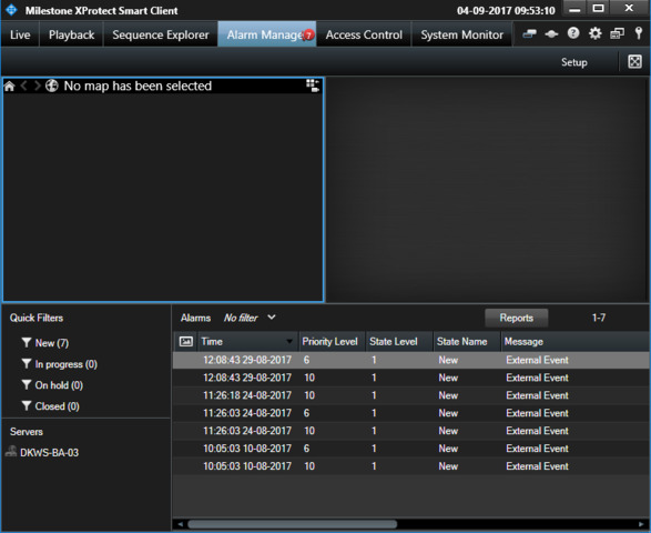

This is the Alarm Manager, it is a workspace (or tab) in the Smart Client:
If you develop a Smart Client plugin you can design your own workspace (and other elements) and you would decide the content then..
I hope I am not confusing by the mention of this. Let me put it this way. -
If the Alarm Manager and what it displays works for you (probably it does) you do not need to develop a Smart Client plugin.
If the Alarm Manager and what it displays does not meet you requirements you can develop a Smart Cleint plugin to get the required display and functionality.
