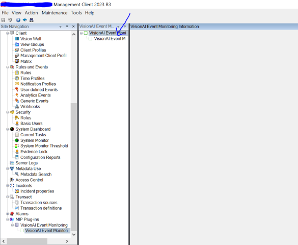

I have a plugin installed under my milestone software. I want to create an instance for it on my management client. Instead of manually opening my management client and navigate to “MIPPlugins” tree node and then clicking on “Add
new” and then providing details and creating one, are there any APIs or methods where I can programatically create one with the needed inputs. I have a requirement when I need to automate the plugin instance creation process

I tried learning about Configuration.Instance.SaveItemConfiguration from MIPSDK documentation and samples. I could see that we are able to create a new item of the own plugin. In my case , I have a 3rd part plugin installed in my management client , will I be able to create a new instance of that plugin? If yes, how can I find the plugin definition ID
