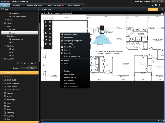

Try this: In the map in setup right-click, in the menu choose Status Visualization. (Nothing you can do in a MIP plugin). I hope it fits what you try to configure..
