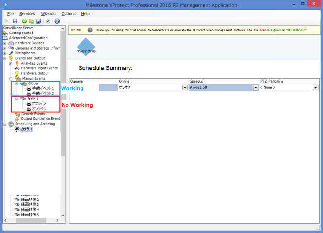

Although it is not important, there were events that did not work depending on the setting.
  • Events created under Global will work correctly.
  • Events created under the camera will not work.
Is this assumed behavior?
