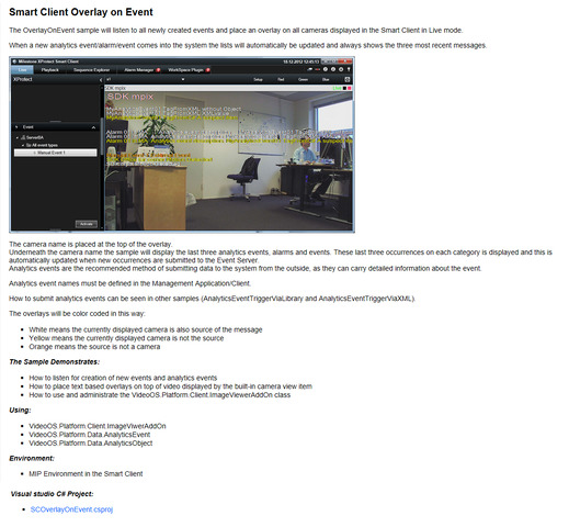

Second sample is Smart Client Overlay on Event sample which is also helpful to know how to display texts on a camera view trigger by events, but it is no longer available on the newest SDK version.
But I just made a link for the SC Overlay on Event sample so please download it and explore the sample too.
https://download.milestonesys.com/mipsdk/SCOverlayOnEvent.zip
