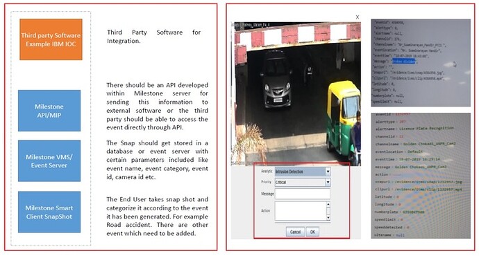

I am new to Milestone Plugin Integration or Development.
We have got Xprotect Corporate 2016 R3 Version. There is particular requirement from Client side. They want integrate Milestone with IBM IOC (Intelligen Operations Center) Software.
I have attached a pic my exact requirement.
I do not see an attached picture..
For now I will point to the MIP SDK Getting Started: https://doc.developer.milestonesys.com/html/index.html?base=content_4.html&tree=tree_4.html
PFA for the same
To integrate this type of information into XProtect I think using Analytics Events will be the best way.
Please see the document -
http://download.milestonesys.com/MIPSDK/Samples/TriggerAlarmFromExternal-ConceptSolution.pdf
This answer will fit if you want to transfer from IOC to Milestone, whether this is wht you want and not the opposite way (transfer data from Xprotect to IOC) is not perfectly clear to me. Please elaborate on what you want to achieve if my answer is not a perfect fit..
