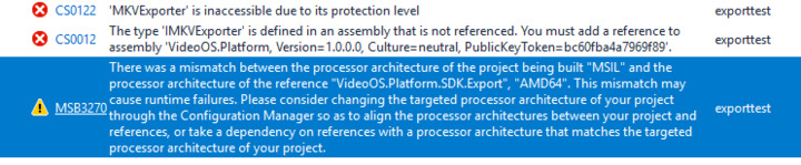

I have tried adding the reference VideoOS.Platform.SDK and VideoOS.Platform.SDK.Export
But When I try to access MKVExporter, it is throwing the errors below
Milestone is planning .NET Core support in the SDK, but it’s not scheduled yet unfortunately.
We are also waiting for the SDK to support .NET Core and therefore UWP applications. Since it has been 2 years, I wanted to ask if there is any update on this and maybe even an ETA?
No, unfortunately not. MIP SDK as it is is very much tied to .NET Framework. There is some work going on to define the next MIP SDK, but the MIP SDK as we know it today will probably not be ported. I am sorry but I don’t really have an update detailing what you can expect and no ETA.
