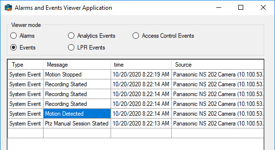

Setting up motion detection is not really a development question and it is important that you know that motion detection is correctly configured and working when you try to use it from MIP SDK code. You can verify that the event happens by using Alarm List in the Smart Client and configure it to show events instead of alarms.
Alternatively, you can use the AlarmEventViewer sample and see when the events occur.
https://doc.developer.milestonesys.com/html/index.html?base=samples/alarmviewer_sample.html&tree=tree_search.html?search=alarmeventviewer
You can see Motion Detection event on the list when the event happens.
This sample will also show you the recommended way of subscribing and getting the Motion Detected events.
