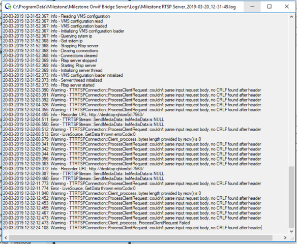

I'm using Onvif Bridge to playback sources from the recording server but it's not stable even with VLC player , sometimes i can view the stream and sometimes no.and i got this errors on Onvif Log.How can i make it stable?
Hi Mohamed,
Is it possible to make Wireshark traces of communication VLC <—> ONVIF Bridge in both cases please ?
