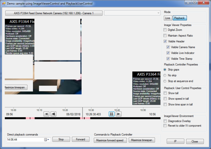

Can you show me a screen capture what it looks like when “trashed”?
Can you show me a screen capture with dagnostic overlay?
Yes certainly.

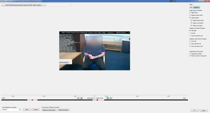

This pic is of another test we were conducting this morning. I’ve blurred out the person face for privacy. While the app was running I hit the maximise button and the video playback froze. Initially in the pic it’s difficult to tell that this has happened but if you look to the lower left of the image you can see remnants of the ‘Maximize timespan’ button is still in the image.

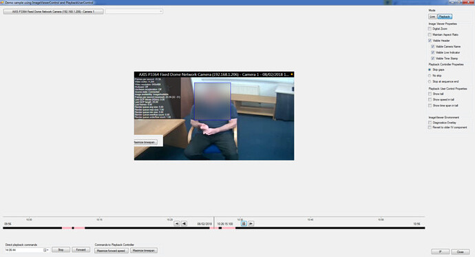

This pic is the exact same pic taken after the first pic first. I hit the minimise button and the result in the video player panel is seen in the pic. Sometimes this result can happen on the first time that you resize. Sometimes there is no error at all and the video will play correctly.
After the errors begin in the player, the UI thread seems to lock up. If it doesn’t lock up immediately then using any user controls eventually causes the app to lock forcing use the Task Manager to close the app, or ( in the dev env ) to stop the app via Visual Studio debug control.
