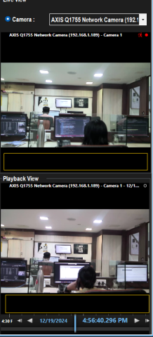

I create ImageViewerControl Tool as shown in below image
In the highlighted area i want tools like follow
How can I add this tools in above video panel ?

You cannot enable the controls from the CameraViewItem. You will need to add your own controls for your own ViewItem.
Some additional information and hints might be available in this older thread. https://developer.milestonesys.com/s/question/0D50O00003UM0eYSAT/toolbar-missing-in-developed-plugin
