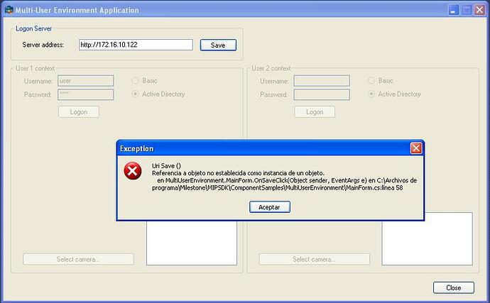

Any time I run Multi-User Environment Sample I get error when press “Save” button. I get:
I debug sample and “siteItem” allways is null. I tried with localhost, network ip, https.
I tried “Multi-Site Viewer” sample and it run fine.
Any idea?
Thanks

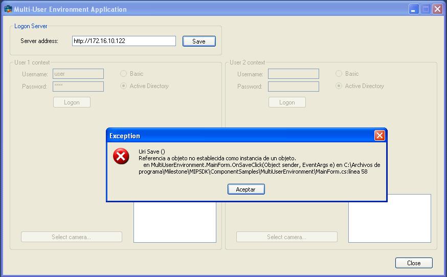

Any idea?
Thanks
I can see that you are using AD credentials.
Please try to login in with a SmartClient from the same machine, using the same credentials (domain user).
Also, try to run your program on another machine.
What do you get?
