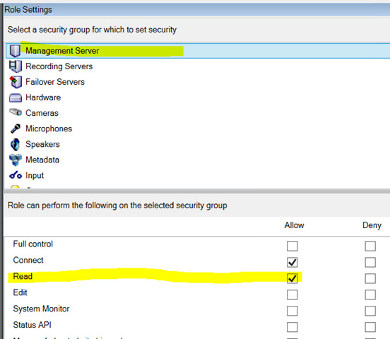

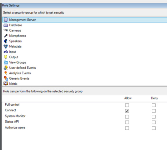

As a result, it is not possible. I tested 2022 R3 Expert (which will be released on 11th of October) but you need to put a user in Administrator group in order to get the user roles. However, if you could use XPCO, then it works fine.
The difference is permission setting.
In XPCO, there is a setting called Read in Management Server (see below).
But in Expert setting, there is no Read setting in Management Server.
