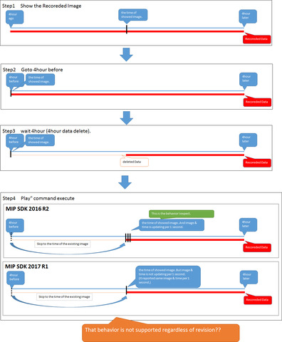

I showed what I want to hear in the diagram.
Do you understand?
Is it right?

Thank you for reporting this, after you used the ilustration I finally understood so thank you for your patience.
We will make a deeper investigation in a Milestone test lab.
