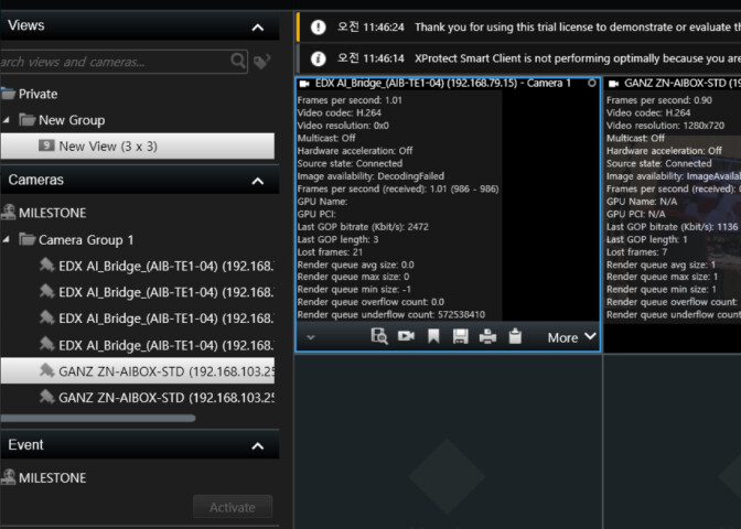

When our new product is registered with Milestone XProtect, video decoding fails in the PC Client (management client, Smart Client), as shown in the image (pclient_decoding_failed.png).
it is a multi-channel Edge AI analysis device developed by our company.
It was connected using the ONVIF Conformant Device driver.
Model : EDX AI_Bridge_(AIB-TE1-04)
Firmware : 61210.1.103700.101
DevicePack : 13.1.130.2
Device Driver : ONVIF Conformant Device
However, the video displays correctly in the WebClient and plays normally in other sw like VLC and ffmpeg.
Our development team finds the issue challenging to pinpoint and resolve due to the device working well with VLC and other VMS products, the assistance of the Milestone development team is crucial.
We have opened the RTSP address to enable quick verification of the symptoms. This stream experiences decoding errors.
rtsp://admin:admin1234@edxvpn.fortiddns.com:7554/live/ch1
Thank you.
