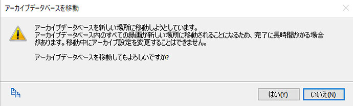

I attempted to change the archive storage location, but the following warning message was displayed.
It appears that if I proceed, all recordings will be moved to the new storage server.
In your previous response, you mentioned that “the recording server can use multiple locations.” Based on this behavior, it seems that there may be a discrepancy with that explanation.
Could you please clarify whether my understanding is correct? Alternatively, are there any prerequisite settings required to enable the use of multiple storage locations?
Additionally, the message states that “all recordings in the archive database will be moved to the new location.”
Does “all recordings” refer to all video data within the specific archive (recording storage) being modified?
Or does it mean all recordings stored on the same recording server, regardless of which storage they reside in?
Message: “You are about to move the archive database to a new location.
All recordings in the archive database will be moved to the new location, and this may take a long time to complete.
You cannot change archive settings while the move is in progress.
Do you want to continue moving the archive database?”
