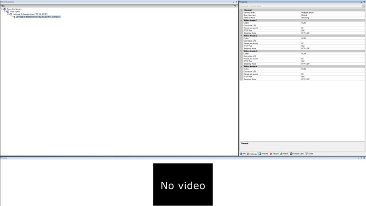

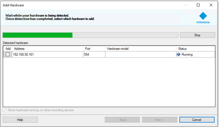

Thanks Bo,
Ok currently we have our camera producing a RTSP stream which we can open completely fine in VLC, however everytime we try and add it to XProtect, it timesout and never finds the stream.
Is there something we’re missing?

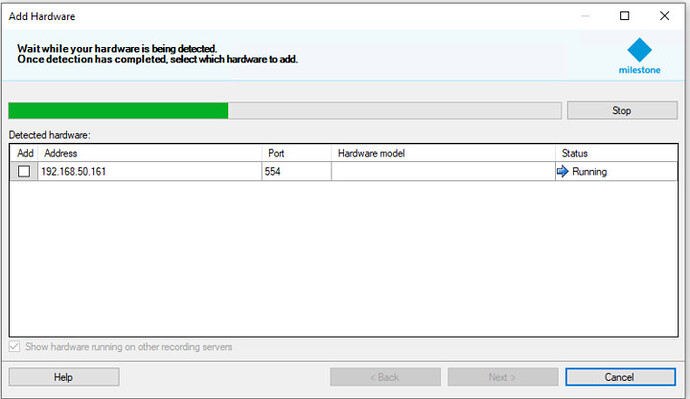

Second image:
There is a knowledge article that might prove useful..
(It even links to a mini manual.)
https://supportcommunity.milestonesys.com/KBRedir?art=000033808&lang=en_US
Configuring devices to work with Universal driver is not considered development and you might get better help from the partners using the support community.
