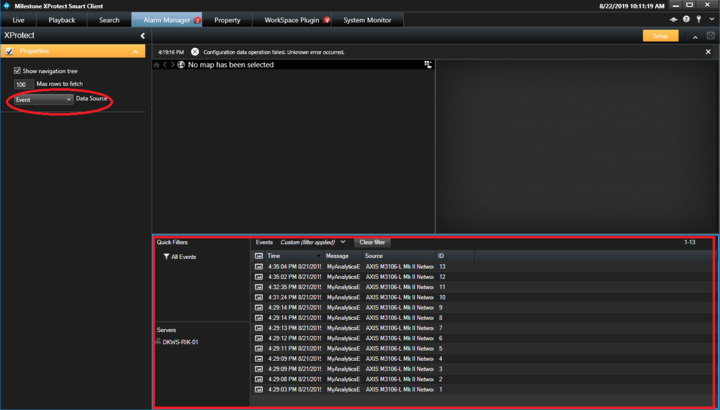

When you run this sample then you can see the event come on Smart Client view.
Start Smart Client ->go to Alarm Manager tab-> select list area(lower view) → Setup → select “Event”
