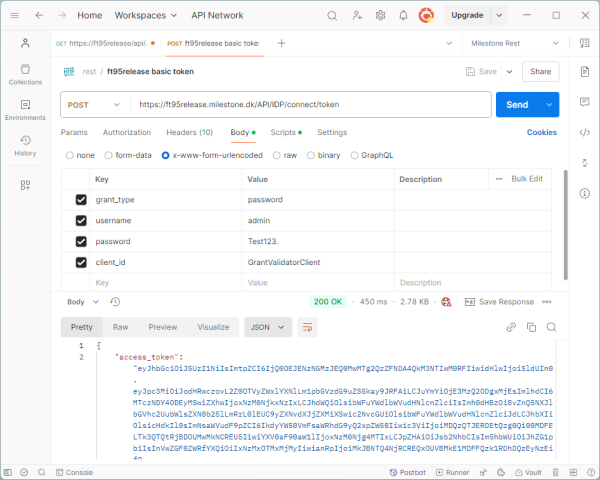

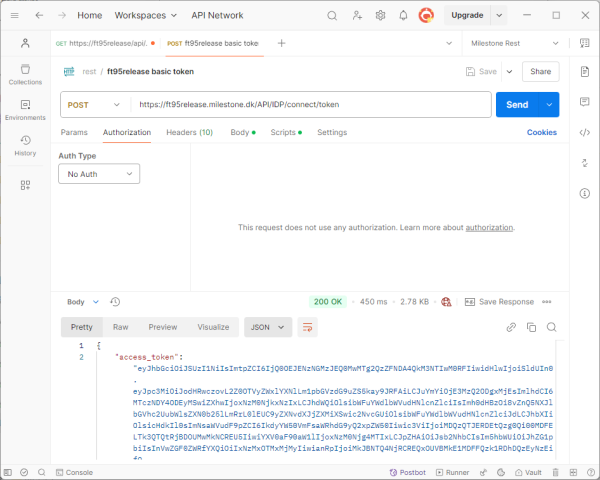

The user, in your case “admin”, needs to be a basic user created in the Management Client (MC). You can verify that the user can login on the MC. I don’t think this is what you are missing, the error would be something else, likely “invalid_grant”.
I am guessing you are following the description here -https://doc.developer.milestonesys.com/mipvmsapi/api/config-rest/v1/#section/Introduction/Get-started

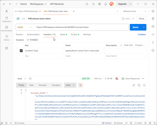

As far as I can see you are doing it correct, I cannot see if you use
--header “Content-Type: application/x-www-form-urlencoded” \
perhaps you can double check this. This is my primary suspicion. See my setup and use from Postman..
Thank you for your content, yes I had forgotten "x-www-form-urlencoded"
