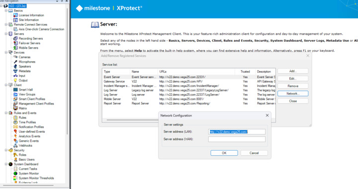

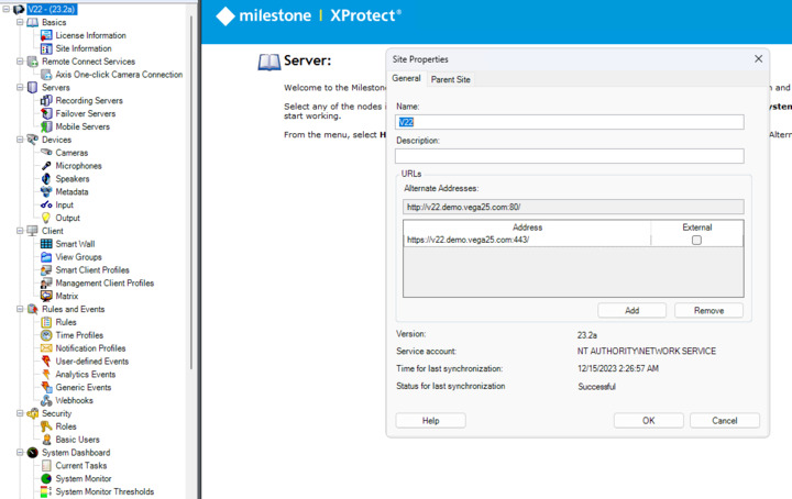

My guess is there could be a mistake in Site properties. (In Management Client left hand pane you have in the top the ‘site’, right click and pick Properties. In the Site Properties dialog, inspect all URLs.
Or there could be a mistake in Registered services. (In Management Client top bar, Tools → Registered Services.., inspect the addresses. Also click the Network button and inspect the settings.)
We check, and looks like all URLs are proper.
