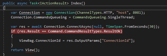

Thank for reply. But my problem is slightly different this. I have an asp.net backend for connect or login.
Controller example:
And pass this ConnectionId with XPMobileSDK.connectWithId(url, connectionId);

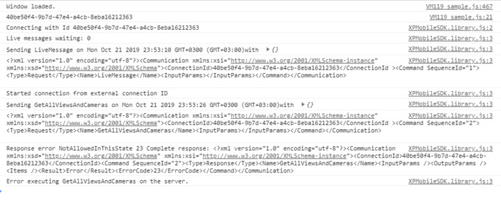

It is observer:
var observer = {
connectionDidConnect: connectionDidConnect,
connectionDidLogIn: connectionDidLogIn
But I didn’t list the cameras.
And console log is:
In my opinion, it was because I did not log in. But there is not ‘LoginWithId’ ?

Hi Said,
I’ve tried something similar (connect and login from .NET based app and perform connectWithId() with already received connectionId).
I receive however different error code - 19 - Security error.
In order to overcome that I’ve disabled chap security:
                    Connection = new Connection(connectionType, _address, UInt32.Parse(_port));
                    Connection.CommandsQueueing = CommandsQueueing.SendDirect;
                    Connection.ChapSecurityEnabled = false;
After that I was able to do connectWithId successfully.
please bear in mind that it is good idea to keep connection alive in your back-end during whole live of the front-end.
