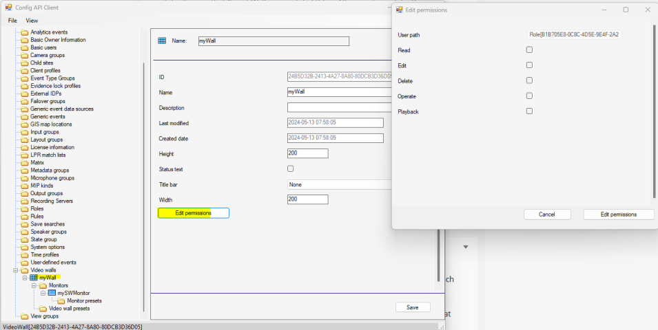

Let me first illustrate this using the Config API Client sample.
https://doc.developer.milestonesys.com/html/index.html?base=samples/componentsamples/configapiclient/readme.html&tree=tree_2.html
If you pick the video wall, you can then do “Edit permissions”, and pick the role, and edit..

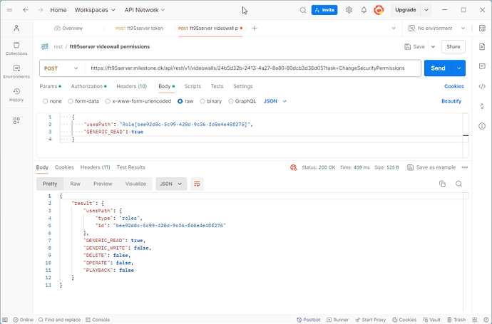

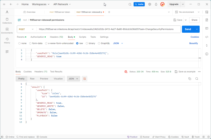

Answering to myself,
apparently it’s as simple as adding the property to the body of the request:
“userPath” “…”,
“GENERIC_READ”: true
Thank you for sharing your experience.
Testing in Postman it looks like this..
