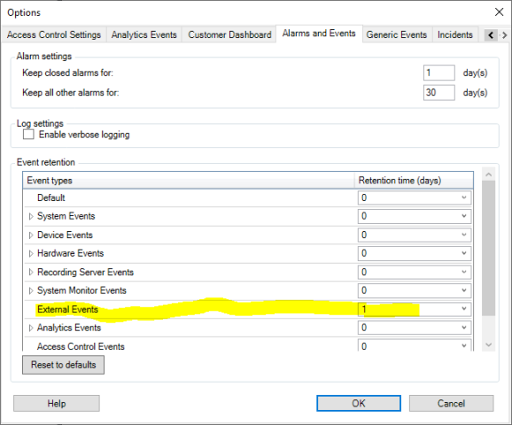

In order to see events this way the events need to be saved.
Please check in the Management Client → Tools → Options, the Alarms and Events tab, under Event retention find External Events. If it is set to 0 (zero) the user-defined events will not be saved at all, if this is the case adjust the settings.
A word of caution, if you set up too long retention and the VMS saves too many events you can cause the SQL Server database to overfill.
Thank you for answer.
I have External Events time set to 1. In the meantime I found out that in example code from github searching was made with api/rest/v1/events?page=0&size=10&include=data and that page=0 was the reason why I didn’t get latest events.
