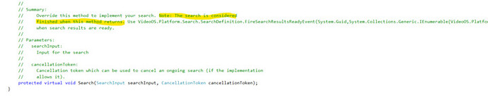

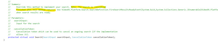

From documentation of the SearchDefinition class → Search Method, it says that "Note: The search is considered finished when this method returns."​
