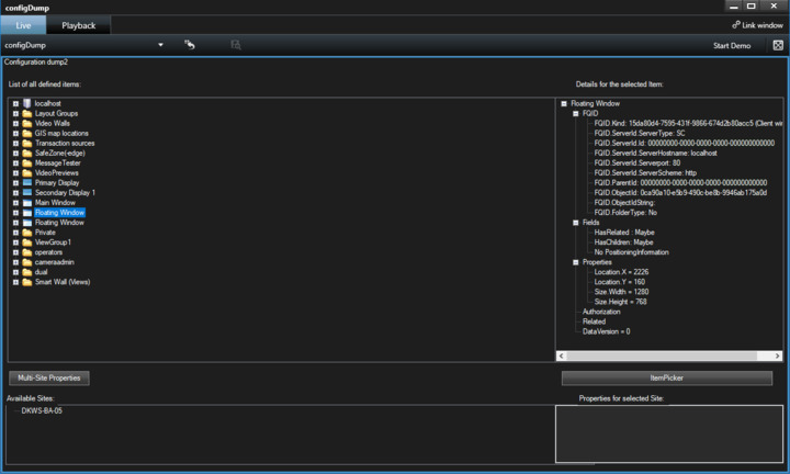

You can get the position of all by reading the properties for the floating window item. If you use the ConfigDump tool plugin sample it look like this:
https://doc.developer.milestonesys.com/html/index.html?base=samples/configurationdump_sample.html&tree=tree_1.html
For getting the floating window you might utilize:
List<Item> windows = Configuration.Instance.GetItemsByKind(Kind.Window);
or if you know the Id of the floating window:
Item window = Configuration.Instance.GetItem(floatingWindowObjectId, Kind.Window);
