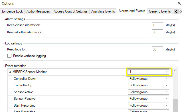

Using SensorMonitor sample, I cannot find how to set a custom retention time for plugin events in MIP SDK. See the field below in yellow:
Is it possible to do ?Thanks!

Unfortunately the only way to manage these setting is to use the Management Client, Tools, Options dialog as you have outlined. There is no way to do this using the MIP SDK.
I checked with the developers to make sure I wasn’t missing anything, this took a little longer, thank you for being patient.
