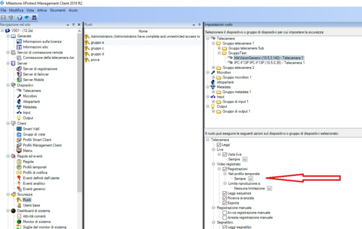

Is it possible via SDK set the TimeProfile as property of an action on a specific camera from a built Role like in the picture?
I have tried with “SetClientTimeProfile()” but i change with success only the login timeProfile of a specific role.

I think you meant to include a picture!? I do not see a picture. I was not able to understand your question without it so I hope it will help me to see the picture.
Sorry, now the picture is ok,
Thanks in advance.
Sorry for not answering sooner. When time profiles was introduced the methods to set these permissions were not updated. I have asked this to be considered for future development work, for now it cannot be used in the Configuration API.
