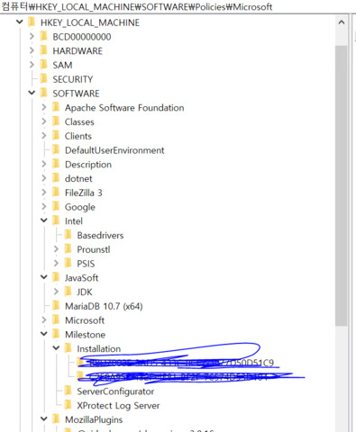

Hi petar
The ONB version is 21.2A.
When I checked the registry settings, the path from the document (Computer\HKEY_LOCAL_MACHINE\SOFTWARE\Milestone\Milestone Open Network Bridge\) does not exist.
What should I do?
Hi Kim,
it is normal - the key is not created by default on installation.
You should manually create it.
Or use the attached reg file.
Thank you Petar :slight_smile:
I solved it thanks to the attached reg file.​
