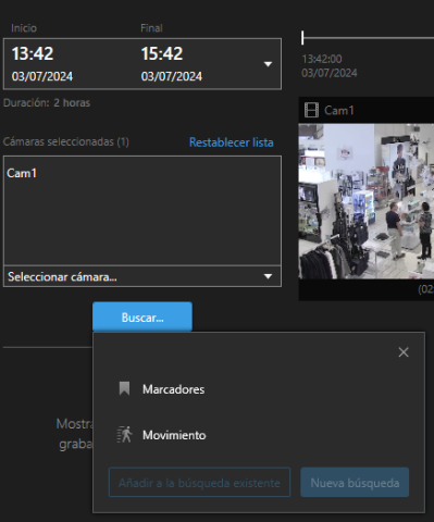

I’m tempted to used the search functionality with our own filters. However, while trying to see how the sample works I’ve been unable to get it working. I only get these two. If I’m not wrong, I should see the PersonWithAccessory and the Animal filters which are not appearing. I’ve just downloaded it from the repo and placed it into the corresponding folder.
Have you restarted the Smart Client after deploying the sample? I just tested on my machine and it shows up without any problems.
