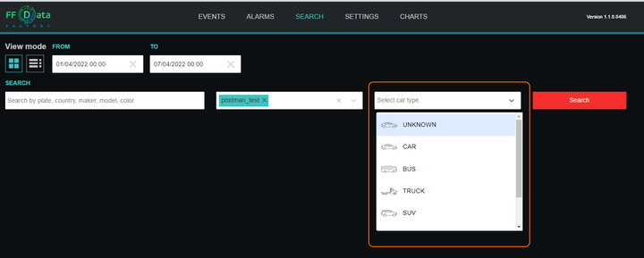

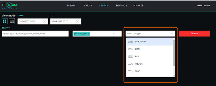

Also in our web interface, there is a function of using filters when searching for the necessary attributes of a car (specifically, you can select the type of vehicle and event source).
These filters are not applied in the built-in browser in Milestone.
In a third-party browser, the functionality works.
Is there a limitation of the built-in browser on the use of such functions?
