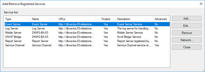

I would very much recommend that you set up DNS in your network.
Less recomended but works also; change the Registered Services so that the Event Server is listed with IP instead of hostname.
Thanks for the quick response. How do I change the ​Event Server to use IP instead of hostname?
Thanks
Change the Registered Services. In Management Client - Tools → Registered Services
Thanks a lot
