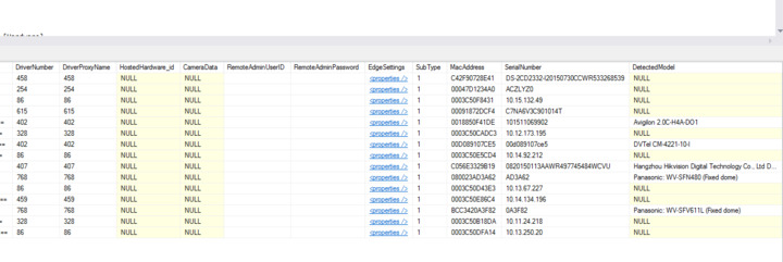

Looks like the reason I couldn’t find a way to get this information is because it’s actually stored in the SQL database that installs itself alongside the milestone install.
Is there a way to access this SQL database ie with a SOAP command or similar? I’d rather not interface with the SQL server directly as in many instances I won’t have the ability to open SQL to external connections.
