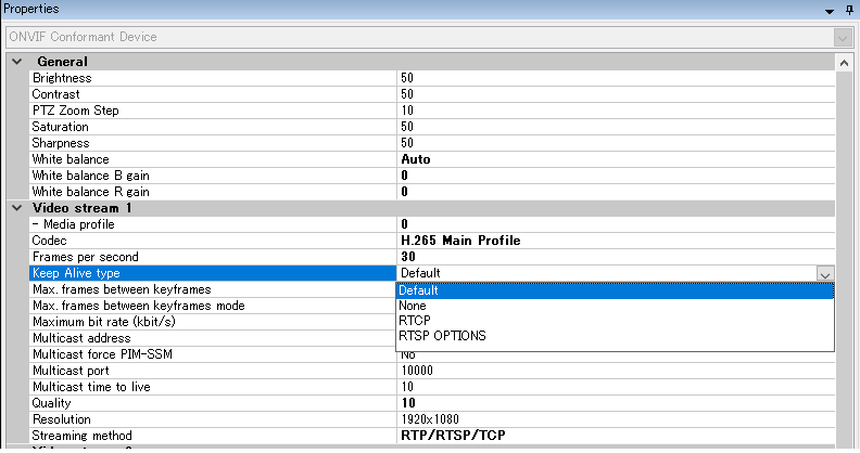

Especially, I want to change Keep Alive type and Streaming method via MIP SDK.
You are right that there is no article that describe or mention this. I am hoping that this screen capture made while using the Config API Client can be the hint you need..

No. Config API Client is only as sample and as other samples you should use it as inspiration but implement your own code.
Config API Client is however a sample that can be used as a tool to discover the structure of things: Recording Servers have Hardware that have Cameras that have Settings etc.
As this underlying structure is the same when you use Rest API, the sample can even be a useful tool when doing Rest API.
Another fact that is nice to know, if it can be done in Configuration API it can also be done in Rest API, also in this sense the two are the same.
My point was actually that what you ask can be done using RestFulCommunication.
In addition to the documentation on the Rest API maybe this is a good read:
https://doc.developer.milestonesys.com/html/index.html?base=gettingstarted/intro_configurationapi.html&tree=tree_4.html
Again it is relevant only because of the similarities in the two APIs.
Finally this might be a better hint..
