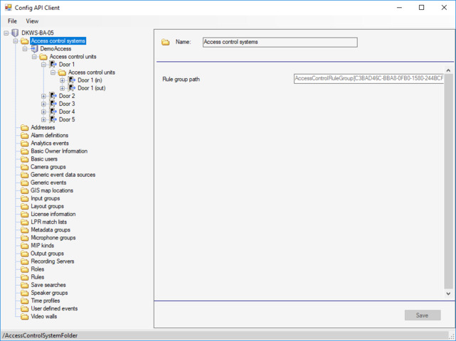

Yes, it is possible now to get the Access Control items in the Configuration API.
This was achieved as a side-effect to the enhancement that was developed that now enable you to configure rules (also rules involving Access Control items) in the Configuration API. this was introduced with 2020R1.
If you have an XProtect 2020R1 VMS with access control and open the Config API Client sample app you see it..
