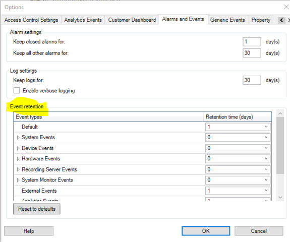

No, there is no way to retrieve deleted alarms because they are deleted from database.
It is possible to setup Alarm and Event retention time, Start Management Client – tools -options -
