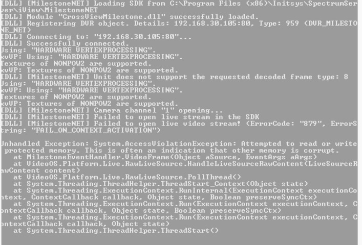

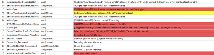

But during the tests, we are having difficulties to access Milestone systems with Xprotect Essencial+ installed on them. The returning errors from the SDK:
