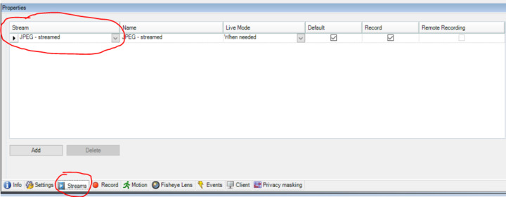

Is there any way (command) how to find out stream type of camera video live stream (see picture below)?
We are trying to show video live stream from Milestone cameras. We use Milestone Mobile Server SDK. We call request stream command with “FragmentedMP4” stream type parameter. But if our customers set JPEG stream for particular camera (see picture below) in Milestone XProtect Management client, then live stream is not “FragmentedMP4” but “JPEG”.
So should we first find out what kind of camera stream our customers have set? And then according to this setting, should we call request stream command with “FragmentedMP4” or “TRANSCODED” stream type?
