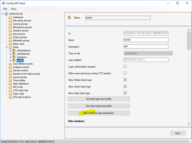

Hi Bo,
Thanks for your response. I checked the sample and failed to the detailed operation permission. Actually we want to get the items of overall security tab for a role. See the list on the maunal guide.
We’re developing a application which need to tell the permissions of current user.

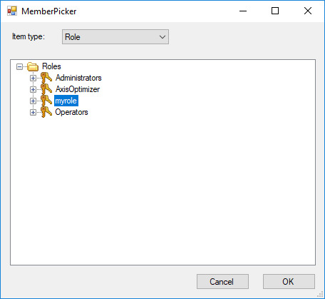

Let us take it step by step:
cc4
Same list as you found in the manual for camera “truCam” for the users belonging to the role “MyRole”.
