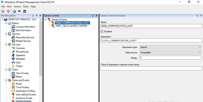

I have one of our plugin that already use Generic Events from Milestone. The tool that I’ve developed automatically create Generic Events in Milestone Management server and Read them back using HTTPS GET command. This works great.

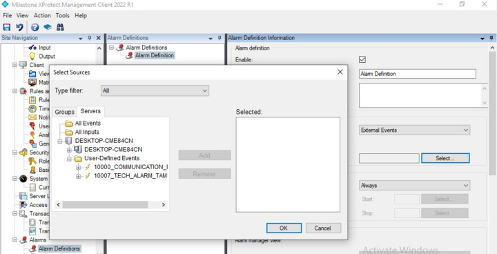

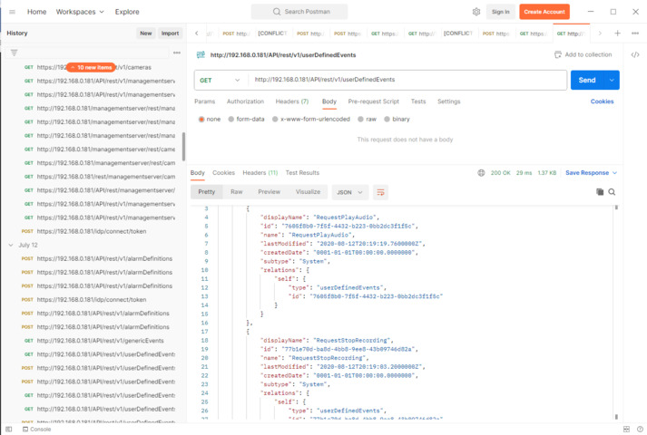

Now I’ve discovered each time you create a new Generic Event, it will automatically create a hidden UserDefinedEvent that is not listed in the UserDefinedEvent menu in the management server of Milestone, but we can have the list when you try to create a new Alarm Definition and specify in the sourceList, the external event type.
I need to get that UserDefinedEvent list to be able to retreive the Ids and be able to create new Alarm Definition using HTTPS POST command from REST API.

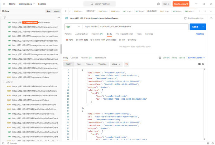

I’ve tested the GET command of userdefinedevents using POSTMAN and I’ve got only Milestone system userdefined Events, not the ones that I’m looking for. Please see the different screenshots for more details.

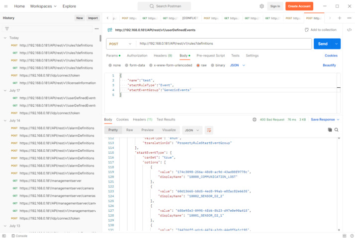

Hi M. Anderson,
Thanks for your feedback on this topic. It is appreciate.
I’ve tested with POSTMAN and it works great as expected. See below the results.
Thanks again for your support,
Best regards,
Ramzi
