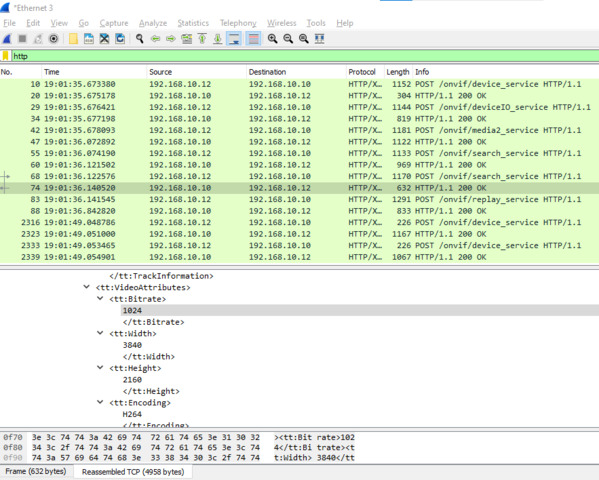

1 Mbps Bit-rate case: Not facing any issue

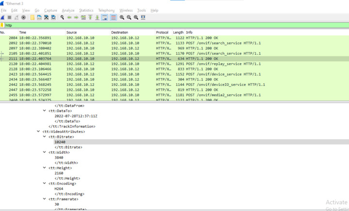

This is the Response we are passing in GetMediaAttributes API call

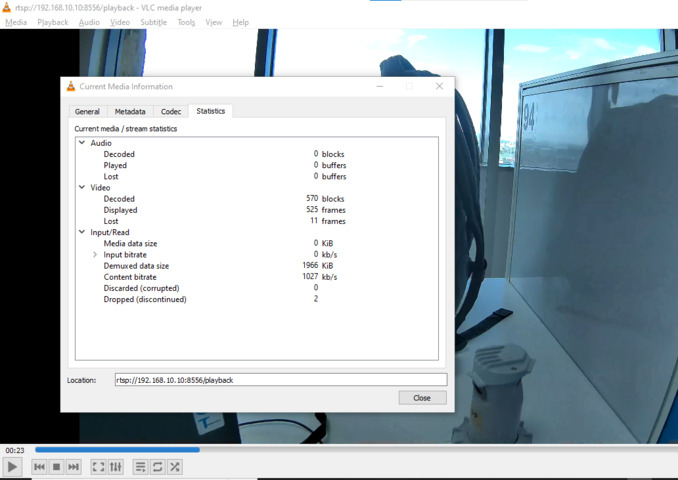

In wire shark RTSP packets we are seeing only one tear down

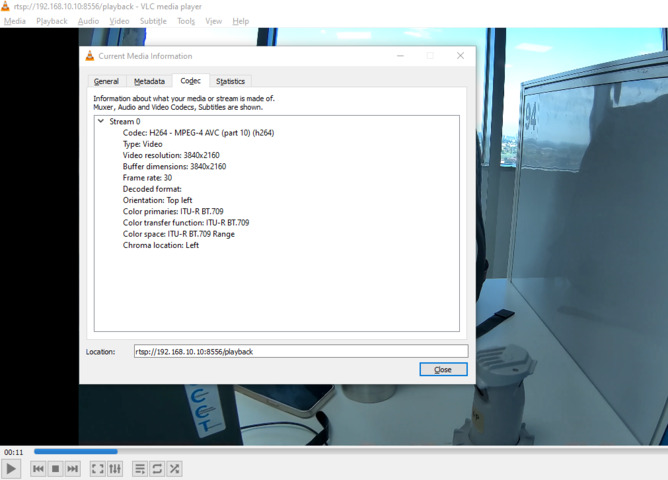

rtsp_1mbpsAnd in VLC the codec information
check the complete wire shark capture with attach file 1mbps_bitrate_case.pcapng

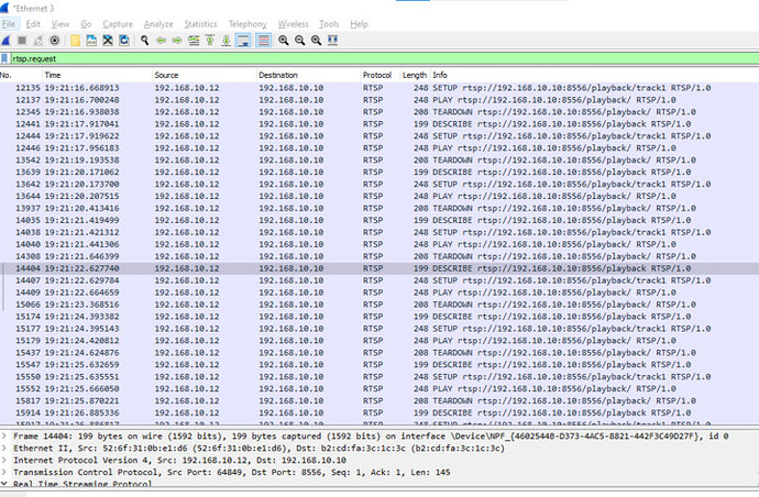

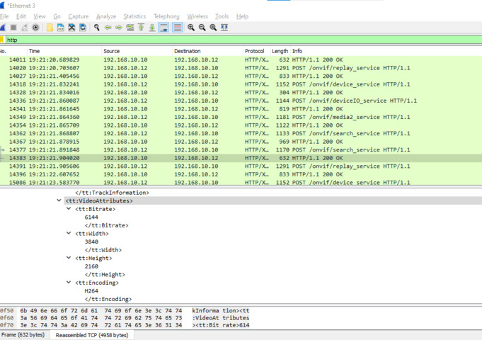

6 Mbps Bit-rate case: facing continues tear down issue

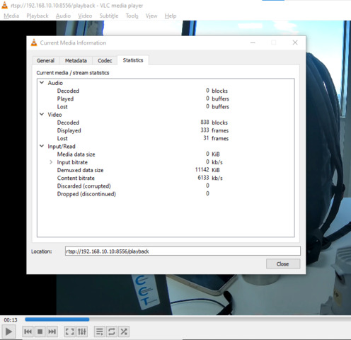

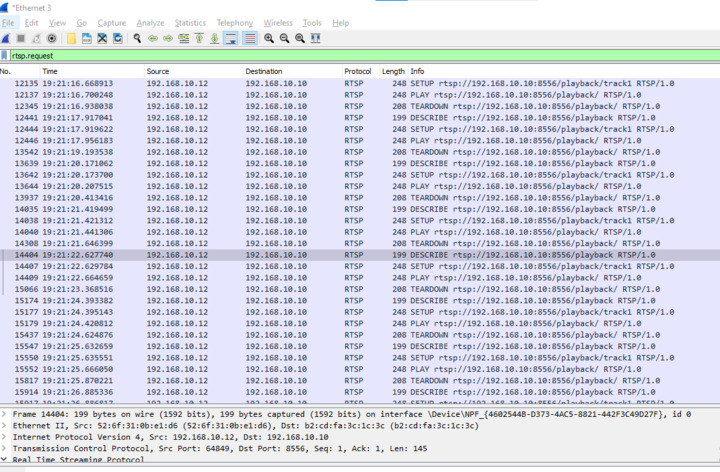

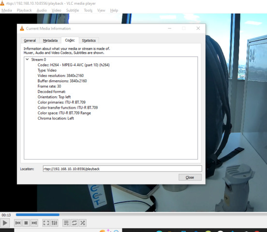

In wire shark RTSP packets we are seeing tear down every play request after But the same URL we can able stream at VLC without any connection issue.
check the complete wire shark capture with attach file 6_mbps_bitrate_case.pcapng

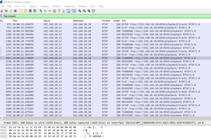

10 Mbps Bit-rate case: facing continues tear down issue

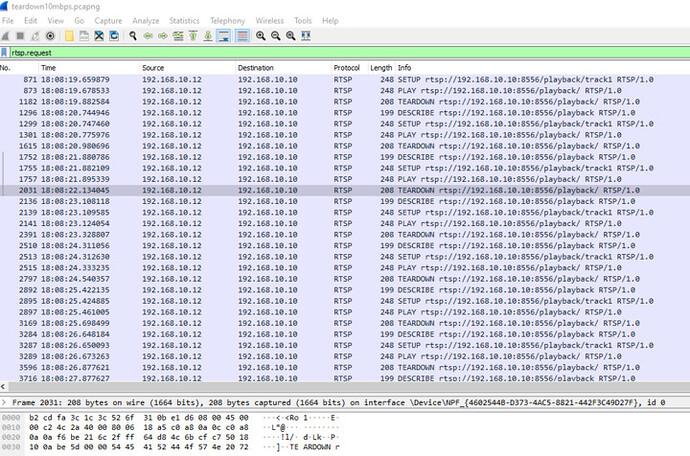

In wire shark RTSP packets we are seeing tear down every play request after But the same URL we can able stream at VLC without any connection issue. Same as 6 Mbps case
check the complete wire shark capture with attach file 10mbps_bitrate_case.pcapng
