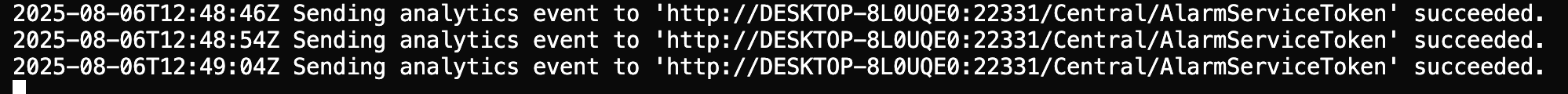

Now when the app detects a person I look in the ai bridge proxy container and I see
the file I send is in the comment below this one
I get the response
'_content': b'', '_content_consumed': True, '_next': None, 'status_code': 200, 'headers': {'Date': 'Wed, 06 Aug 2025 12:52:40 GMT', 'Content-Length': '0'}, 'raw': <urllib3.response.HTTPResponse object at 0xffff2803b910>, 'url': 'http://10.26.35.15:8382/event/86e3aed3-1553-5d23-8d61-2286215e65f1/person/analytics_event', 'encoding': None, 'history': [], 'reason': 'OK', 'cookies': <RequestsCookieJar[]>, 'elapsed': datetime.timedelta(microseconds=21602), 'request': <PreparedRequest [POST]>, 'connection': <requests.adapters.HTTPAdapter object at 0xffff2803b160>}
But for the person in chair class I see in the ai bridge proxy
with the JSON

And the responce I get is
{'_content': b'', '_content_consumed': True, '_next': None, 'status_code': 200, 'headers': {'Date': 'Wed, 06 Aug 2025 12:55:09 GMT', 'Content-Length': '0'}, 'raw': <urllib3.response.HTTPResponse object at 0xfffea4109970>, 'url': 'http://10.26.35.15:8382/event/86e3aed3-1553-5d23-8d61-2286215e65f1/person_with_chair/analytics_event', 'encoding': None, 'history': [], 'reason': 'OK', 'cookies': <RequestsCookieJar[]>, 'elapsed': datetime.timedelta(microseconds=5331), 'request': <PreparedRequest [POST]>, 'connection': <requests.adapters.HTTPAdapter object at 0xfffea4109250>}
2025-08-06 14:55:09,667 - INFO - Milestone event 84a8942b-5772-4d0d-9ae3-33f71df495e5 uploaded successfully to http://10.26.35.15:8382/event/86e3aed3-1553-5d23-8d61-2286215e65f1/person_with_chair/analytics_event
Why is this happening ?

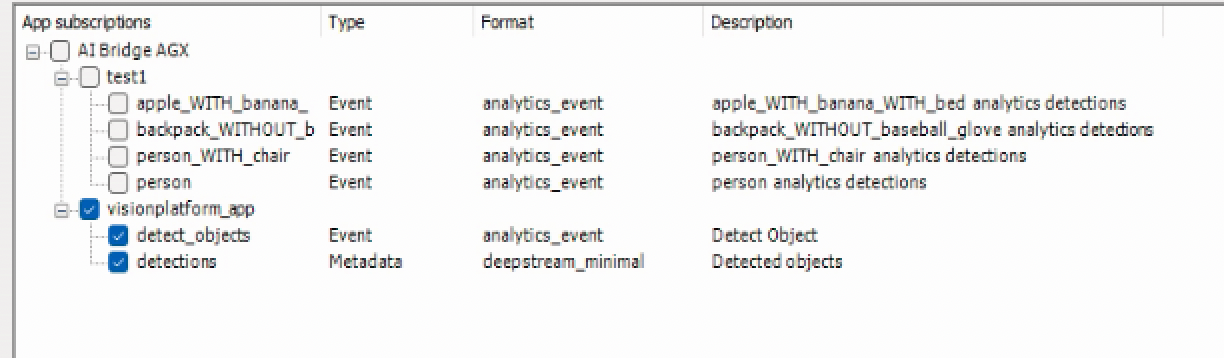

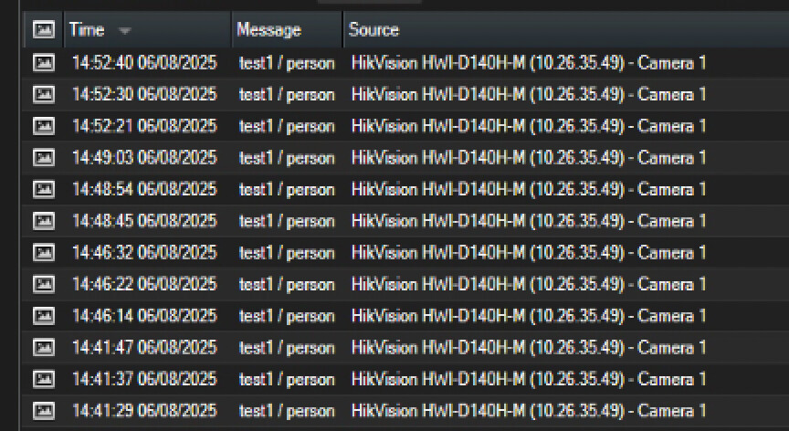

Question 2)
As you can see in the picture the camera is not registered to the app
but when I look at the smart client I see events for the camera
how is this connection even made?
Question 3)

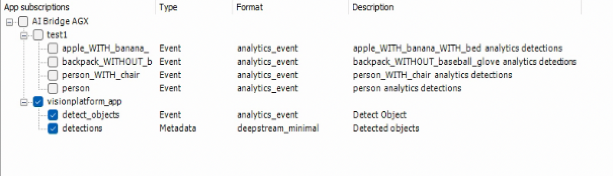

When the person topic is removed and the app is updated. I see that the new app does not have. a person class but when the person class is added again the camera automatically is subscribed to the topic. Its almost as if there is a database where the camera stores all the topics it was connected to and remembers.
Can you explain this persistence ?

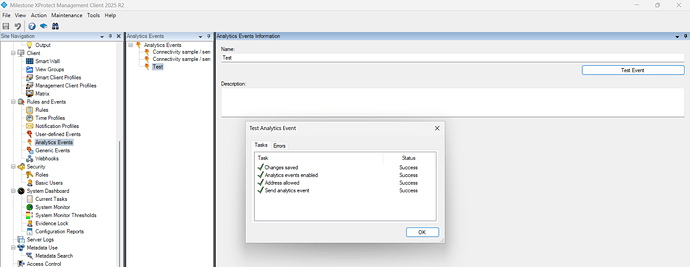

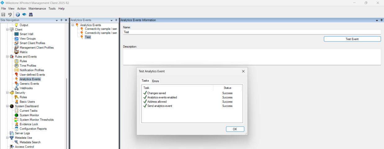

  • Ensure the analytic event is being sent using the test button in Management client at Rules and Events/Analytics Events, [The event name you want to test], then click “Test Event” and select a camera. This should be the result:Afterwards, the event sould listed on the events list in Smar Client.
:red_question_mark:About question 2:
  • Since XProtect allows sending events from any device (you may see it on the previous point validation where you can select any camera) AI Bridge cannot prevent sending the event as long as the json is well formed and the identifiers are correct.
:red_question_mark:About question 3:
  • Unfortunatelly we have a bug on the persistance of data on the topics checkboxes, even it you unregister the VMS, applications or even remove and add topics when registering the app differently, the checkboxes values are always remembered. Even, the numbers of subscribers for at topic may be misleading because of this same reason. Modifying the application ID that is being registered on the AI Bridge could be a workadound. Sadly, there is not other workaround for this behaviour except modifying the Surveillance database but this could lead to unstable states of the VMS or AI Bridge and it is not recommended.

I am thinking when the app registers each time it starts up there is a persistence of memory that is causing an issue. But why it does not effect the person class I dont know.
I also think the one thing I did was I checked the box between 12 and 1700 so checking the box took a sort of snapshot and is causing wierd issues
To test this I need to somehow refresh the database how can I do it ?

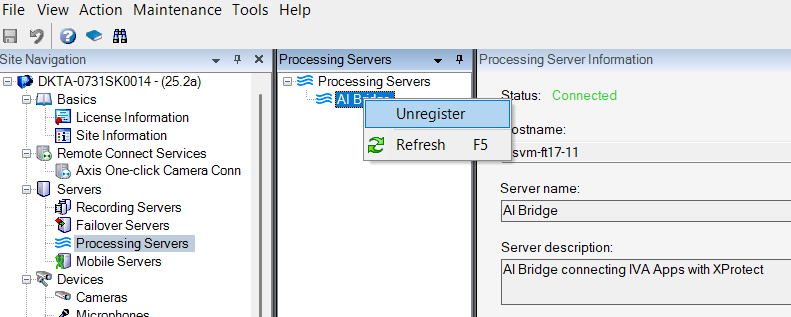

Hello @Sharath Rajampeta​,
Thanks for sharing your setup. I’ve been trying to replicate your scenario without success, unfortunatelly.

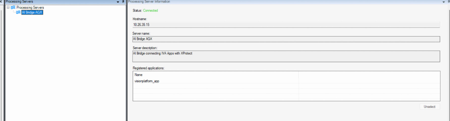

I can recomend you one more thing to test:
  1. AI Bridge is running (init container stopped succesfully and connector syncronized 100%)
  2. Navigate to Management Client/Processing Server
  3. Right click on the AI Bridge connected instance
  4. Click on the “Unregister” option:
  5. Wait for the connector container to finish the unregistration, you’ll see log message such as:
Disconnecting from endpoint http://[VMS_HOST] succeeded
AI Bridge unregistration for endpointID:'[SOME_GUID]' succeeded
Observer with ID 'application-unregistered[SOME_GUID]' removed.
After this, restart AI Bridge and test again your scenario.
Note: if you do not find the “Unregister” option on the context menu in Management Client, it’s because you are using an old version of the Processing Server Admin plugin, please grab latest from here (Milestone AI Bridge resources) and upgrade it.
Please, let me know how it goes.
Regards,
Fer
