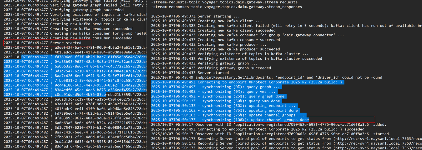

I have AI Bridge connected and working. I was able to get the streams of all my cameras through it, graphql was perfectly fine - I used it for multiple things (registering app, getting camera IDs and streams…etc - and it’s fine).
All of a sudden the streams stopped working. I have attached the logs.

Looking at the logs look like the AI Bridge was restarted while the app was currently pulling video.
During this time (start up) there’s a sync process which ended at (2025-10-07T06:50:17Z - connector log), the streaming container stopped producing this error at (2025-10-07T06:50:16Z - streaming log).
1- Would you mind restarting your application again ?
