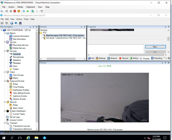

I also tried your suggestion. However same result. Below are my testing.
Test 1:
private DateTime \_keyDate = DateTime.UtcNow;
protected override bool GetLiveFrameInternal(TimeSpan timeout, out BaseDataHeader header, out byte\[\] data)
  header = null;
  data = \_demoConnectionManager.GetLiveFrame(Channel, false, 90004);
  if (data.Length == 0)
    return false;
  byte\[\] identityBytes = new byte\[4\];
  byte\[\] messageBytes = new byte\[data.Length - identityBytes.Length\];
  identityBytes = GetIdentityBytes(data);
  messageBytes = GetMessageBytes(data);
  int keyFrame = BitConverter.ToInt32(identityBytes, 0);
  data = messageBytes;
  DateTime dt = DateTime.UtcNow;
  if (Convert.ToBoolean(keyFrame))
    **\_keyDate** \= dt;
  header = new VideoHeader()
    CodecType = VideoCodecType.H264,
    Length = (ulong)data.Length,
    SequenceNumber = \_sequence++,
    SyncFrame = **Convert.ToBoolean(keyFrame)**,
    TimestampSync = **\_keyDate**,
    TimestampFrame = dt,
  return true;

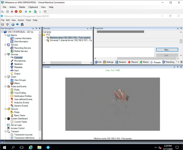

Key frames are OK but when non key frames are displayed. Gray image are shown
