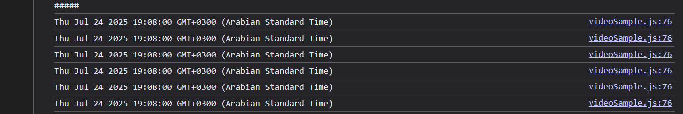

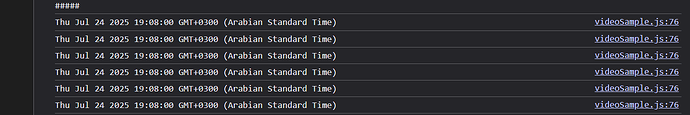

I have executed the code that you provided and i still get only the last frame in the last record, so when i log the timestamp i get the last frame time but this time this frame dataSize is 0. i don’t know why this is happening but anyway i still get only the last frame of the last record this camera have
Thanks a lot for your help, and have a great day

first thing i was trying to change the time into UTC, because most of the stream and playback i have worked with in Milestone service was the same thing.
No after i have checked your response, I’m getting the time correct but i have only one frame and when i log the timestamp of each frame i get the same time of the start, but with dataSize 0.
Thanks again for your help, Have a great day

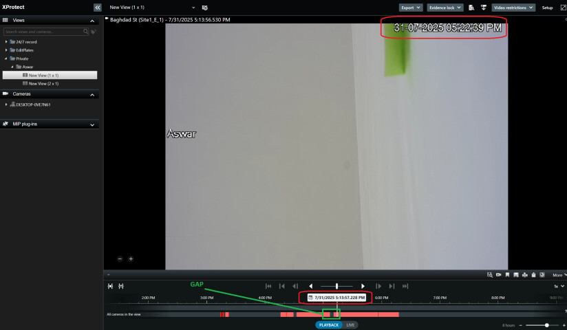

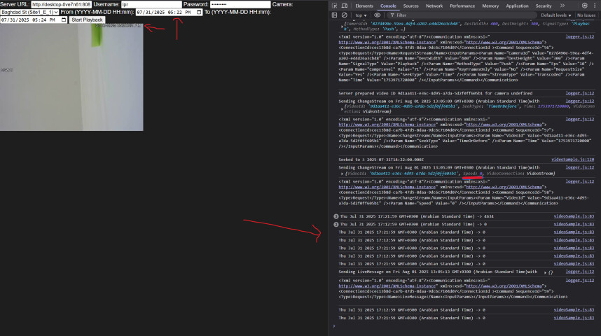

Hi @Cagri Kayalar
Thanks for help, but i don’t understand how it’s not working with us and works for you. I test the same code on two different machines, and i always check the video time before fetching. if you look here in playback:
And the camera is connect right now :
Now i will try to get the playback with the time (start, end) that exists in first image:
event when i try to fetch the time that on the frame :
so can you share how it works on your side with the same code?
and if it possible to setup meeting to solve this issue because it’s very urgent that will be super helpful

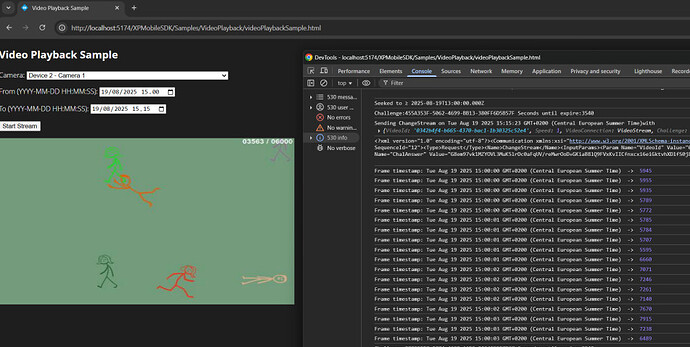

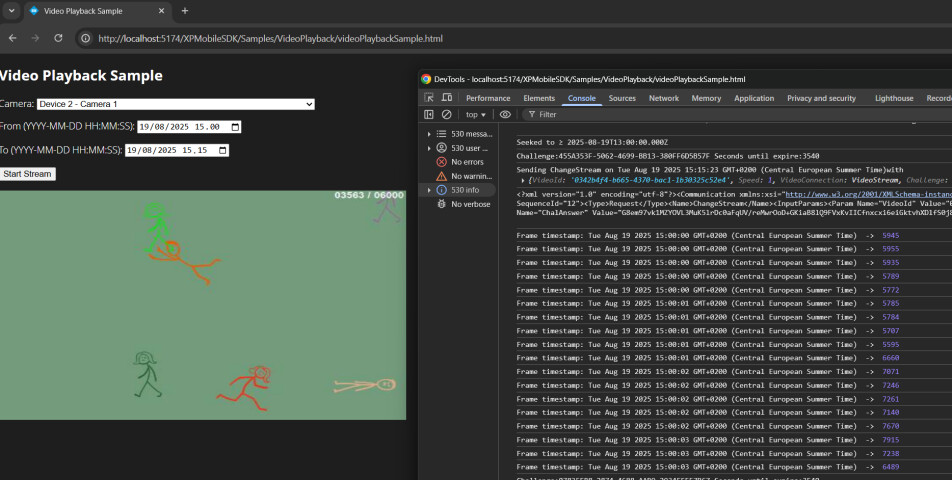

Hi Abaas,
Sorry for the late reply, I have been on summer vacation.
Here is how it looks when I run it:
And this is from Smart Client:
And it works as it should when I try with different servers also.
One thing I noticed in your screenshot is that there is a gap between recordings. So maybe you are trying to get recording for a time interval that doesn’t have recordings. You could check it and try to get the recording for the time interval that has recording, to see if that works.
I’m also attaching the sample code that I was running. You can extract it and put in under “mipsdkmobile-web/Samples/” folder and run it the same way as running the other samples. Just make sure to add url, username and password fields in the code (i added TODO next to them). Let me know if it works for you when you try from the sample.
I hope it will be helpful. Have a great day.
/Cagri
Hi @Cagri Kayalar
Thanks for your response. We solved the issue from another third party source.

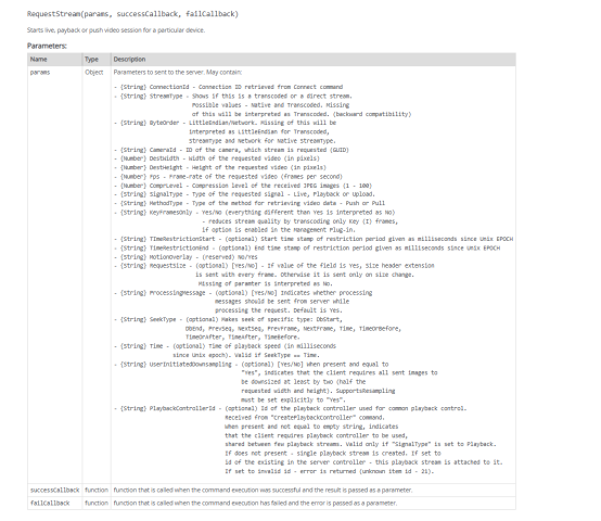

The issue is in the RequestStream Params. if you notice it’s don’t contains Speed property and it’s sending the default value which is 0 if you look at this image i sent before:
after just adding Speed 1 my code is working without any issues. We need to know where we suppose to find such this documentation because this issue toke from use 2 Months and this is hold us down. I Know you will say in this documentation of Mobile server or in this Samples but we didn’t find this in any of them. and in the documentation the RequestStream function you never mentioned about the Speed:
Also @Constantina Ioannou​ Said i should open new ticker and i did in this link.
Thanks a lot for help.
Have a great day.
Hi @Abaas Mahroos
I’m happy to hear that the code works now for you. And you are correct that Speed doesn’t seem to be among the properties of params, then that would obviously cause confusion. Thanks for pointing out to that parameter that seems to be “hidden” for some reason.
However, if you check the code I sent you initially, you can see that there is a line where I set the speed inside onStreamReady (it is line 9 in below snippet):
