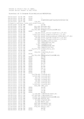

You are right, it should not be there. It seems that it might be mixing up. Also you may miss some dependency files. We would like to know which files are missing, so could you please show us your SDK Bin folder, such as “[C:\Program](file:C:/Program) Files\Milestone\MIPSDK\Bin”? Can you send us an image of the folder?
Hi Rie,
I’m attaching the contents of [C:\Program](file:C:/Program) Files\Milestone\MIPSDK\Bin.
Thanks!
Can you please check if some dependency files are missing? This tool may help you to check.
http://www.dependencywalker.com/
After checking it, please tell us(or send me a screen shot) what you missed?
Thank you. I have been able to solve the problem. It had to do with DLL paths.
I had this same issue using the x86 binaries and Depends was not helpful diagnosing the issue. I simply bulk copied all of the binaries out of [C:\Program](file:C:/Program) Files (x86)\Milestone\MIPSDK\Bin in to my solution folder. Hacky but worked.
