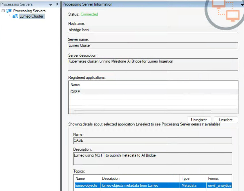

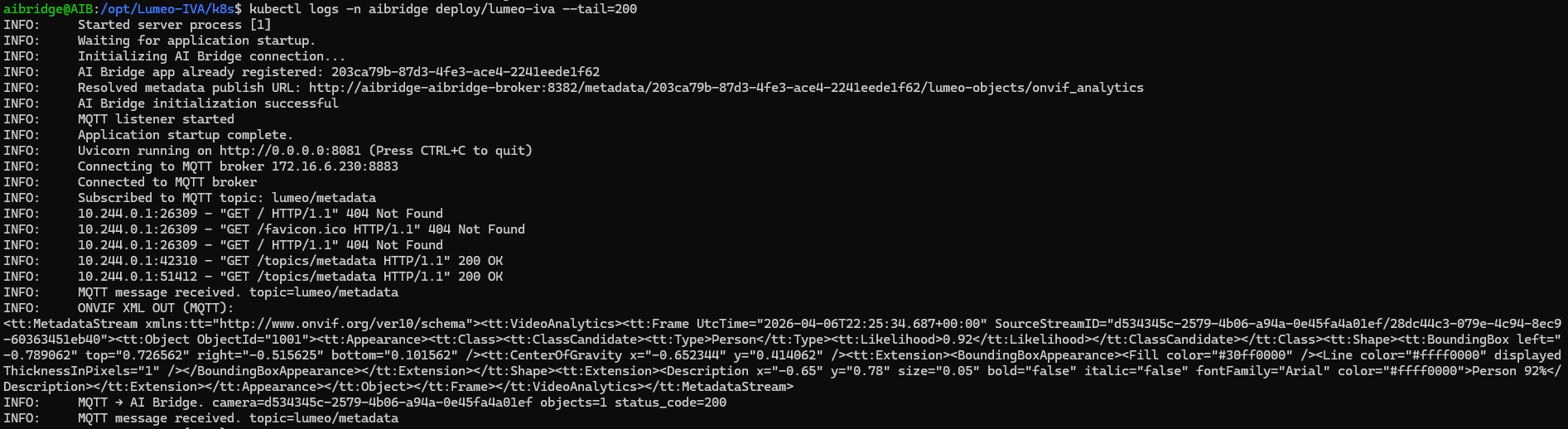

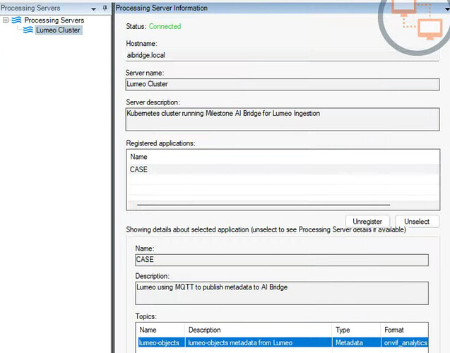

Hi! I recently deployed a version of the AI bridge starting with docker. I was able to get it working and to show live metadata (bounding boxes). But with the Kubernetes version I have not been able to successfully show metadata. I have troubleshooted all the areas I can think of. The bridge says its connected, I have a camera subscribed to the metadata channel, the IVA app is successfully connected. The protocol for transportation is MQTT. All logs show the MQTT packets come in, the app transposes them to onvif analytics format (XML) sends to the AI bridge and successfully returns a 200 from the Bridge. No IVA app code has changed when it was working with Docker AI bridge.
The app successfully registers with graphql, I have queried and confirmed everything is working as it should.

All Pods are in healthy order. But when I check logs on connector, or streaming - while running a live test, I see no output. Which tells me the metadata isn’t reaching the pipeline.

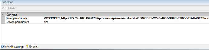

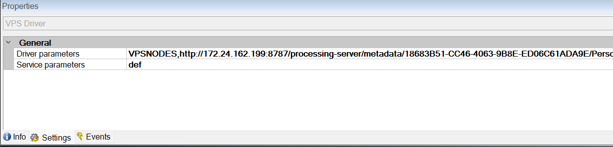

The VPS Driver settings are used on the Recording Server to reach to the AI Bridge, so in your settings, like:
the url after “VPSNODES,” must be reachable from the Recording Server, and of course valid for the environment.
It could be an idea to unsubscribe form the metadata stream topic, and then resubscribe (= setting up a new VPS Driver with correct settings).
