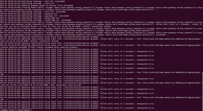

The init container stays on this error:
We’ve noticed this error happens if there is anything wrong - i.e. we’ve had it when the basic user isn’t right, or other errors - it is not a great indicator of what is wrong unfortuantely.

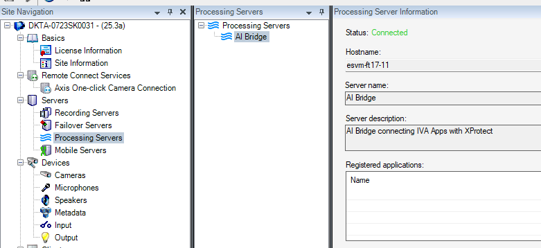

We also tried to add this (i.e. uncomment out the ip/hostname - this gets us half way there, meaning we are able to see our application in the processing server in Milestone Management Client, but we still end up with the error of: unable to reach health-endpoint.

Sure thing, please find logs below:
webservice:
Error: Error adding endpoint: Post "https://MGMT-SVR1/ManagementServer/ServerCommandService.svc": dial tcp: lookup MGMT-SVR1 on 10.96.0.10:53: no such host

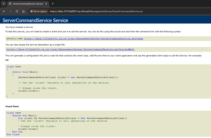

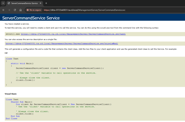

You’ll see, the XProtect protocol integration dictates that for basic users - user type that AI Bridge is using to connect to XProtect -, the authentication must be done throuhg HTTPS, regardless your VMS setup. You can read more about it here: https://doc.developer.milestonesys.com/html/reference/protocols/protocol_authenticate.html
Having this in mind, and as an example, I can share this setup:
  • XProtect is not running secured:
  • AI Bridge connects to this XProtect
  • The enpoint is reachable from another host (not XProtect machine, nor AI Bridge machine) using https even when XProtect is running unsecured:

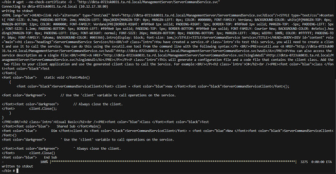

  • Inside the connector container, a wget command can be run to check the connection to the host and this particular resource:
    • In my case:
wget --no-check-certificate -O - "http://dkta-0723sk0031.ta.rd.local/ManagementServer/ServerCommandService.svc"
  • In your case:
wget --no-check-certificate -O - "http://MGMT-SVR1/ManagementServer/ServerCommandService.svc"
Can you please, check that you can access this resource for the hosts you are mentioning that can reach the VMS and from inside the connector or webservice containers?
